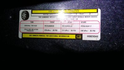

No door sticker has trailer tow capacity on it, that has bad information. You’re probably seeing GVWR, or gross vehicle weight rating, which is not the same thing.
That's what I thought too...

Speaking of door tire stickers, my truck has 20s on it, and the spare is a 17...!?? Gee, I hope I don't get a flat because, while I'm no expert, I don't think a 17 would ride well with 3 20s...? Or, am I missing something? Thanks.

that's the tire sticker, not really the one i was referencing. the one i'm talking about has the vin number on it as well. it shows the trucks GVWR, which is the maximum the truck is legally allowed to carry as a payload plus the curb weight of the truck and a 150 lb driver. it has nothing to do with towing, and everything to do with how much it can carry.
Gotya... GVWR = 6900.
I was merely pointing out the stickers did not show the tow capacity...
