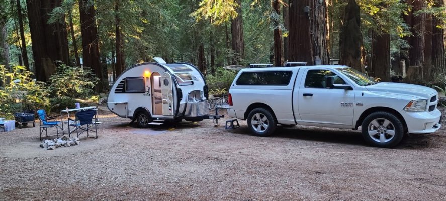

Here's the official capacity chart for your year. Find your exact model and configuration and look at the numbers. Don't exceed the recommendations for your vehicle. Any incident with an overweight vehicle opens up liability opportunities not to mention safety issues. Have fun with your camper. We tow a teardrop style with our Ram and it's been a blast getting to fun, out of the way places.
