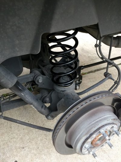

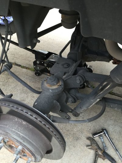

I ordered the McGaughy's 2" rear lowering springs for my 2014 CC RAM. I must say that this was one of the easiest things I have ever done. I simply removed the shock bolts and lowered the axle, and popped the old springs right out.
I then inserted the new ones and buttoned it all back up. Literally, the entire process including removing and placing the wheels took about 35 minutes.
I really love the new look.
A comparison of the springs:
You can see the shock removed and the old spring out:
New spring installed:
T

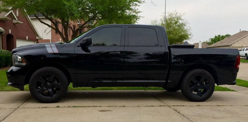

Rides like stock! Feels good. I love the new look.... subtle but still looks a little meaner.

I didn't see this before, so I thought I would say nice job! The truck looks great and am curious about what he said ^^^^

Your truck looks awesome at that stance! Love the murdered look..too much washing for me to buy black..
