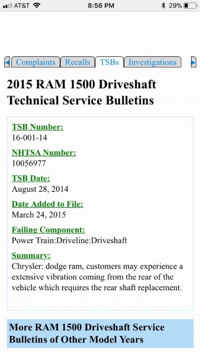

Dealership thinks it’s this...
I’ll let you know how it drives after the driveshaft is replaced!

Glad you got some sort of answer!
