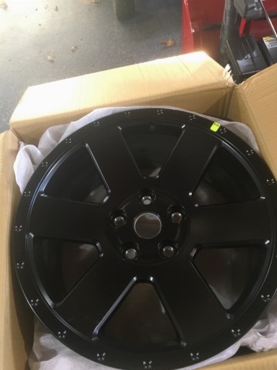

Wheels come matte but look WAY better glossy like they were on the car show Ram that debuted them. Gonna get them powder coated when they come in..
My truck is granite metallic. Should I go gloss black or like a dark gray gunmetal gloss? I’m torn but want the wheels to look good.

Mopar wheels came in! Unfortunately I still have no truck to put them on!
Those look awesome!
Care to say how much the 4 of them ran you?

Those look awesome!

I found the best price I could on them I think they were around $420 a wheel. Gonna throw them on the next truck I end up getting.
