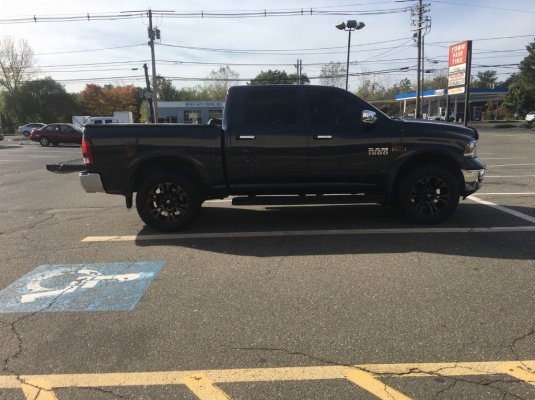

The wheels came in today (5 days early!). Guy said they were supposed to be coming from California but apparently they must have found them closer. I’m having them installed tomorrow I’ll post some pics once they are on!

Looks great. The wheel and truck colours look very good together.

Looks like they were made for you truck.

Make sure you're lugs are torqued properly and check the centers of you're wheels periodically. I read somewhere on here where someone was having issues with Fuel wheels cracking around the lugs. Wheels look great though.
