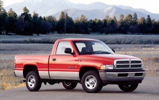

First off if it is a 2002 1500 you should be in the third gen section if it is an 02 2500 then you should be in this section. Assuming your body style looks like this ImageUploadedByTapatalk1419790118.802602.jpg the abs computer should be directly below the cupholders on the floor. Check your fuse panel. I believe there is a slot for it under the hood, otherwise you will need a special code reader to read the abs codes from the obd2 port and begin diagnostics from that.
