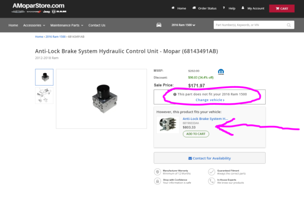

A new control module is only $220 from the dealer online. You have AlphaOBD. What does a repaired module cost???
Can you give me the link to get a new one from the dealer online for $200?
