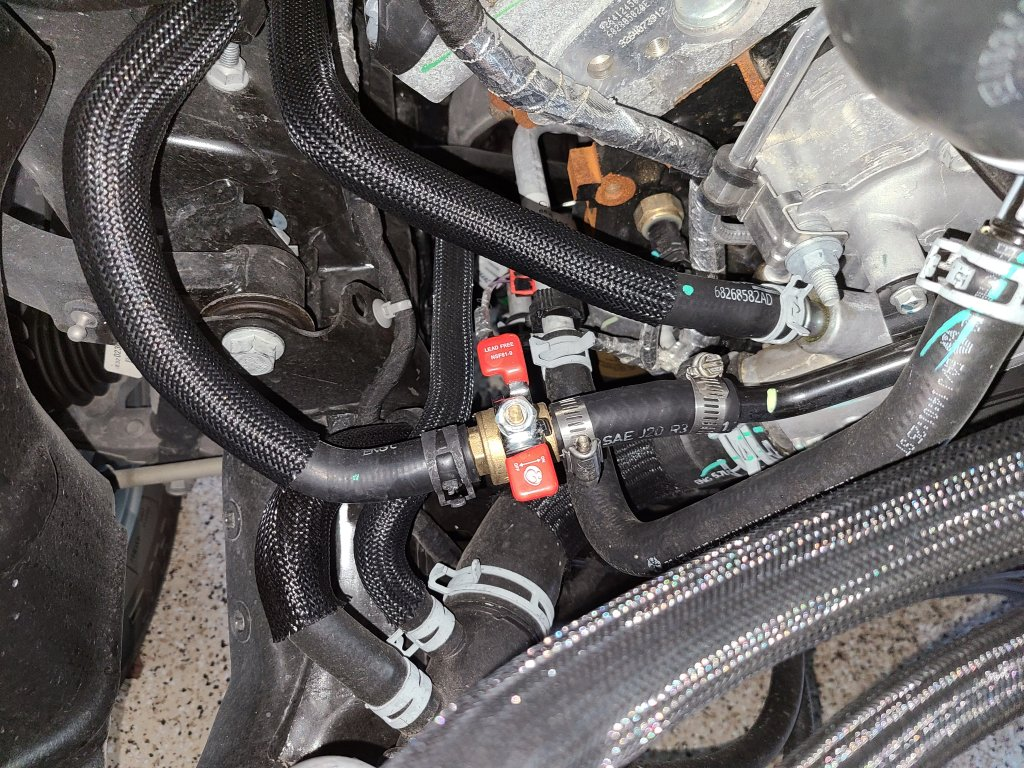

Pinching off the heater core line or installing a valve. Search Muzzy's AC hack. Very simple. Many have great results. I personally have not done it. My AC is ok. Blows 50 degres at vents. Some say they get it down to 44ish with the mod.
My AC, with the TSB done, where they added sensors, worked on evaporator, and such, got my temps down to 48 ish, as long as under 95 F degrees out may hit 46. If I clamp off the inlet line from the water pump to the core, I get down to 40-41 degrees, and that is even sitting still, not pushing air. But I have not clamped off the line this year. I do have a valve and all the parts necessary to put in a manual valve, I am just lucky not drive much. But temps been sometimes at 110 F and more, which is at least 15 degrees above normal, just miserable.

See my post #50. Also, PW Chief, you could check the TSB and see if your vehicle falls under it and decide if U want it done or not. I will post here the Original TSB number which I had my work done and also understand there was a modified TSB number. But beware, if they do the TSB, they Pull Out Everything: Dash, Vents, Blower Motor assembly, etc.

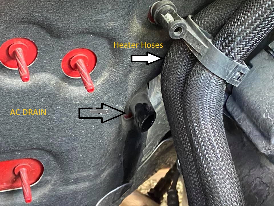

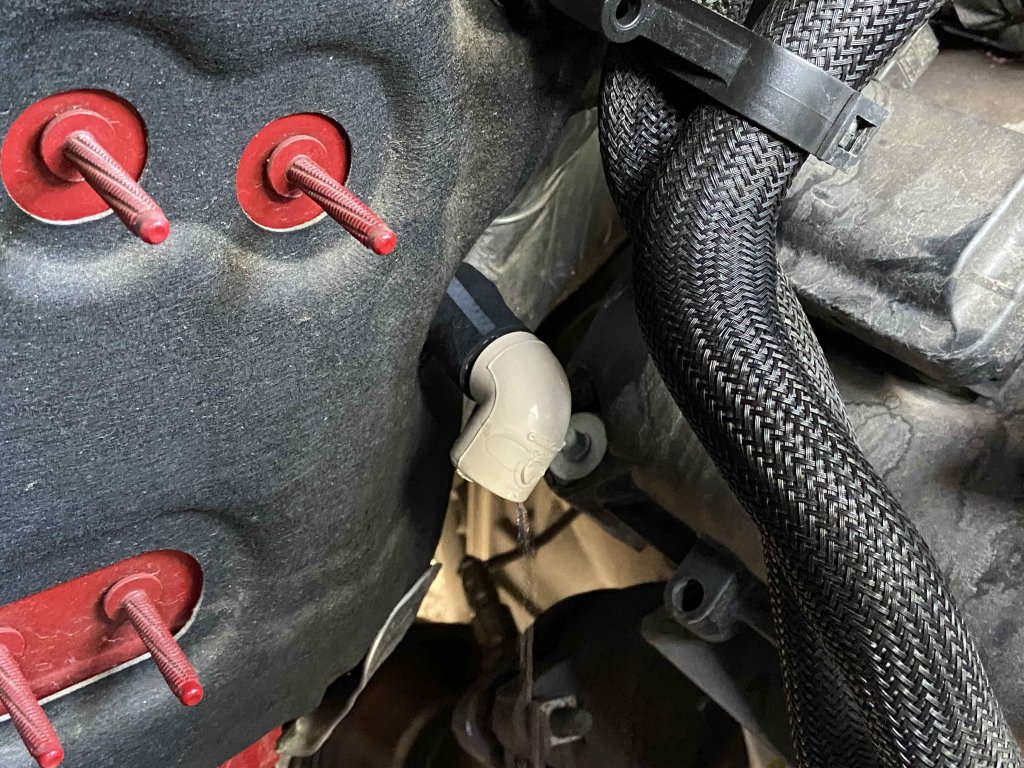

ADDED: Also check your AC drain, and make sure not clogged. Since it drains off the firewall now and not down under, it can get clogged, so I did a lil hack to assist with that, and yes when I checked mine, it was clogged.

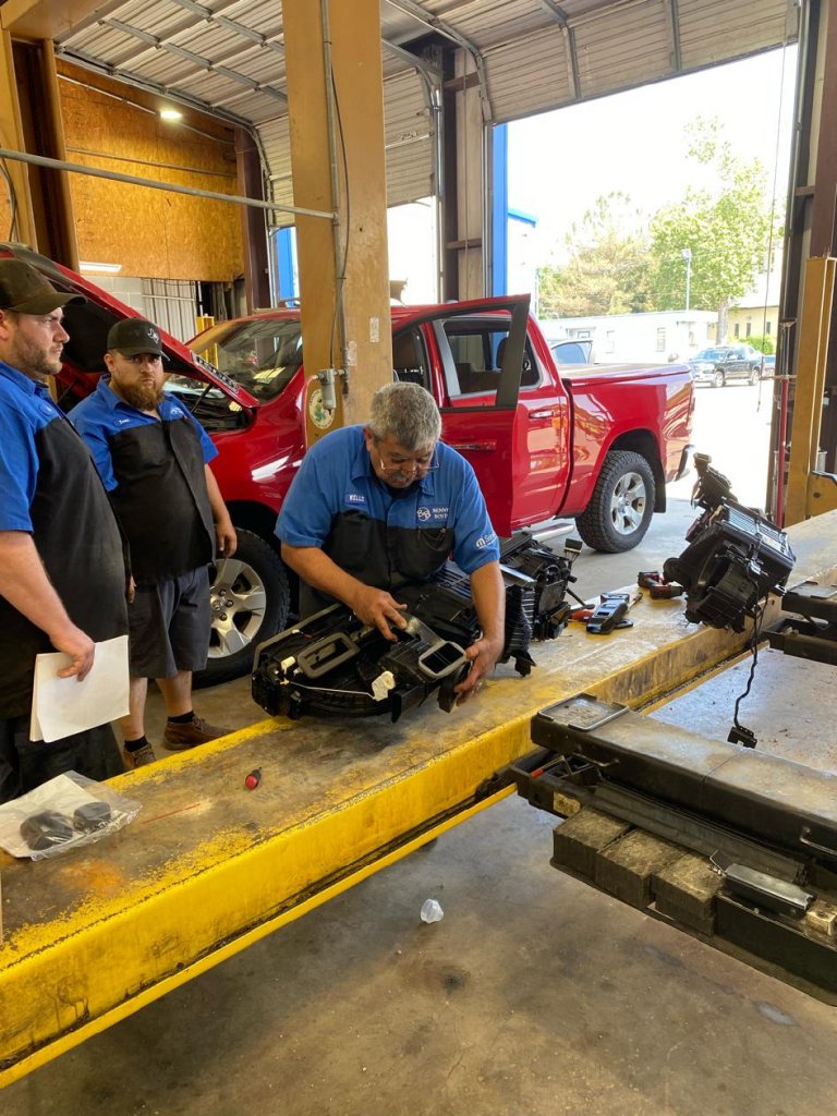

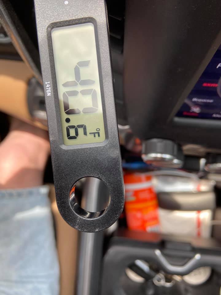

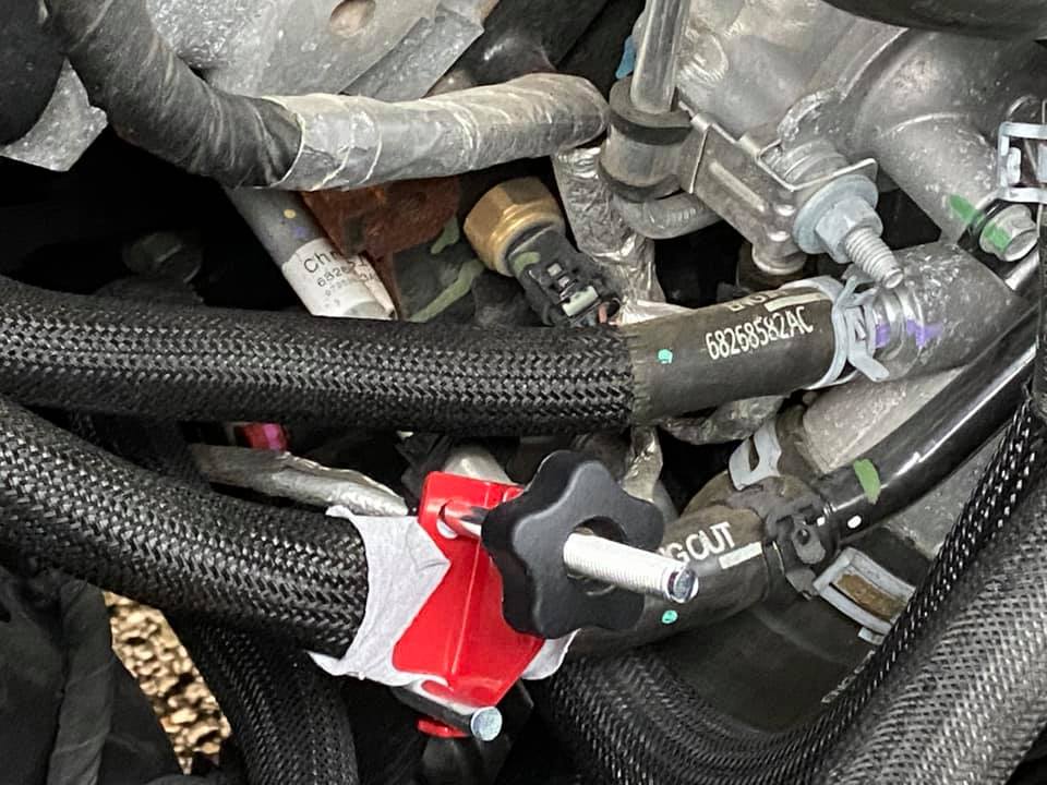

PIC 1: AC Drain Location. PIC 2: Pic of hack done using valve (not mine). PIC 3: My lil Drain Hack. PIC 4: My Clamp Hack on My truck last year.
PIC 5: Vent Temp with Hack installed. PIC 6: Dealership mechanics working on my TSB.
Original TSB: TSB 24-OO1-19: Pic: MY 19 truck having the TSB done: Note the entire vent channels out, to the right HVAC motors and system: What U not see is the steering wheel pulled down and the other parts of the dash and lower box areas apart in truck.
