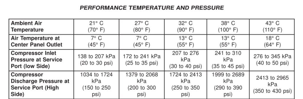

This is a chart you can use to determine if the system is charged correctly or not.
At least you did get it working.
