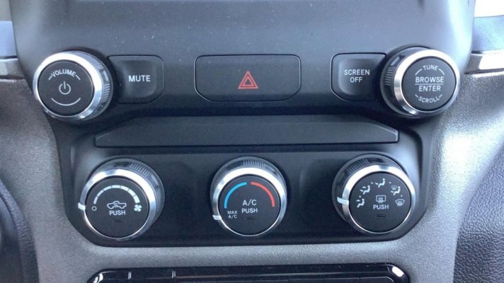

Unless the outside ambient air is very close to my desired inside cab temperature and not too humid, I usually set the Recirc to enabled for any use of the AC system.
I would truly appreciate learning how I could configure my Warlock to a default of 'Recirc enabled' as soon as I turn on the AC. It seems daft to me that it's not already a SOP with all vehicles.
On mine, I only have to set the temp control knob all the way to the left/counter-clockwise position and it stays on Recirc.
That makes perfect sense to me.
Unfortunately, or not, the ambient temperatures in my area versus the performance of the HVAC on my truck, never require such a drastic setting.
Also, I have the Auto temperature setting feature, I set the desired inside temp and forget about it unless on a longer road trip when I must increase the temperature before frostbite sets in.

Yeah, I have no problem with my A/C either. Half the time I have to turn the vents away from me because it's too cold, and that's on a 100 degree day. I also never have mine on Recirc because I haven't found the need. I just noticed that if I turn the knob all the way left it automatically goes there and I can't take it out of Recirc unless I turn the knob back to the right just a bit.
So, if you were to set the temperature fully CCW, does the blower blast on full tilt until you get tired of listening and reset the temp?
The Auto temp setting on my truck functions almost perfectly and the blower is pretty quiet after the initial cooling period on a hot day.
No, my blower/fan has a separate control knob that works independently from the temp control.

Agreed...weird to see knobs that you turn apparently to make air move faster/slower and a separate knob for warmer/colder air...my mind is blown!!! Haha.
I keep my AC on Auto, recirculate on, auto temp set at 60 degrees. Whether on remote start or hit button in cab. But sometimes, the system over rides your choices and disables recirculation, especially when system senses a humidity/defrost situation. It will over ride recirculate directing some "air" towards the windshield, gotta luv how the truck "outsmarts" U and the controls U want activated, LMAO.
