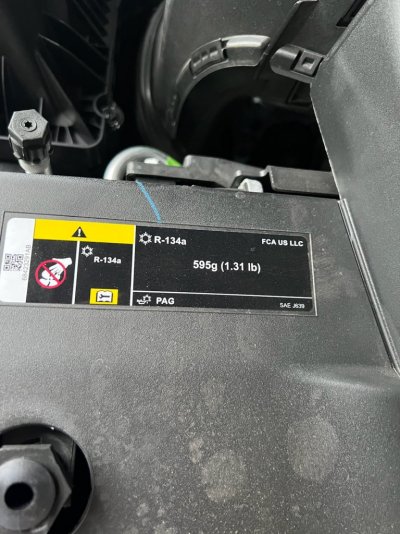

Before U throw R134 in there, U better check and see if U do not have the New R1234Y in there. Not sure if the 2500's HVAC system are using different Freon than when they changed over *** amount of years ago.

100% sure I have 134a, fyi my truck was built in Mexico thus I lucked out to not have that crappy enviro 1234y junk Freon like CA & USA trucks get stuck with....
