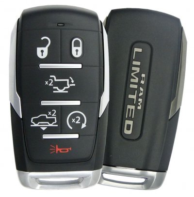

From what i have seen
You will need to get the special ignition switch, about $70 up to $600
https://www.moparoneonline.com/oem-parts/mopar-ignition-switch-6ck46dx9ac
Then you need to get a different RF Hub, it is behind the rear seat on the drivers side, next to the vent $81 - $117
There may also be antennas to buy ?
Then you need 2 RKE $139 - $149
depending on your Rams options
Then you need the wiring harnesses
& someone to install it all
Then it needs to be programmed $$
