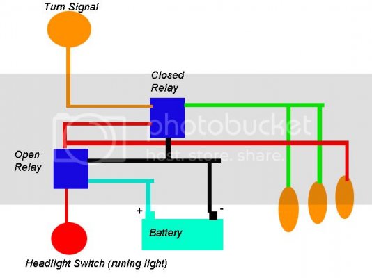

alright, well i will begin adding lights here soon. What i would like to do, is be able to add running lights and cab lights, that can act as turn signals as well. on the cab lights, it will only be the two outside lights on either side that will be turn signals. The cab lights i am getting are the Plasmaglow sky pod 10030 smoked cab lights with reverse lights. Full LED from the get go. I was planning on getting a set of lights that i could swap out the base for the bulb with a dual filament set up, but i fell in love with these the second i saw them and noticed i could buy 'em new for $50. So, i bought 'em. I also am planning on adding running lights down the side of my truck, probably using LED strips from superbrightleds. Now, the issue is that i know all the lights i will be getting will only have one power lead. The idea that originally came to mind was to use some relays. But i realized the relays would work great if i wanted to run the lights as turn signals when my running lights are off, but as soon as i turn on the running lights, the turn signal portion would not work because they would be getting constant power from the running lights. So, how can i get around this? is there a special relay i can order or buy locally that will recognize a primary and secondary source? or am i in way over my head? The back of my head keeps telling me there has to be something out there that would work perfect for my application, and yes, running a set of lights that i could replace with dual filament bulbs and bases would be the easiest way to go, but thats out of the question...i believe i can get strip lights with 2 leads that will work for my side running lights (for a hefty cost increase) so if this is going to turn into a 30+ hour electrical install, i will go that route and just have marker lights for my cab lights, but if this is something i can do in a couple hours...i'd like to do something unique. questions comments and help appreciated! thanks in advance

Well you have an interesting idea there man. Well I have an idea that comes to mind but would need someone to back me up make sure my thinking is correct.
Ok lets break down the problem.
You want to be able to have running lights down the side of the truck that won't blink.
Then you want to add cab lights that will come on with the running lights but blink if you turn. Ok well you will have to stick with me here. Anyone else if you see an error in my logic do tell me.
Ok so here goes.
You could use a standard relay for the running lights. That is the cake part. Run your trip wire from the park switch to activate the relay. Easy.
Now the blinking lights for the cab lights is a little more difficult.
Ok first thing that comes to mind is a normally closed relay to be used for the cab lights. Running the switch wire to the turn signals. So when the cab lights are wired to be on they would turn off every time the turn signal would blink. Does that make sense?
Not to mention you are gonna have a lead for the white LED also to wire in.

so what your getting after is use the power wire for the blinkers to open and close the circuit going to the cab lights. so that whenever the blinker is on, and power in the wires fro them, the cab lights are actually off, than when there is not power in the blinker wire, the lights are on. so that the running lights will still work, and the cab lights will still work. that sounds right to me...but like i said, i'm a novice with electrical. lol. and fyi, my the LED running lights that will happen in the future i would like be able to run as both blinkers and running lights as well, so what i do here, will tell me if i can do with with the other lights as well. and the second lead coming out of my skypods for the "reverse light" feature will be wired up to a switch. (my back up lights haven't worked since i bought the truck, so i am gunna hook up all my reverse lights to a switch, so that i can use them in other situations other than being in reverse.)

That's pretty much what I'm saying. If you want them to be running lights and turns well you could do the same thing or you will need some sort of an IC chip or something to lower the voltage making them pulse and not turn off completely.

i would be fine with them just turning on/off instead of pulsing. so something like this would need to be done for the wiring....right?

Yes a dual relay setup would be best. That looks about exact. Now you would need to do the same thing with the running lights when you do those. I bet you could probably use the one closed relay.

yeah, i bet i could get away with using just one closed relay, since everything will be LED, i'll just need to put it all somewhere i can hide it and still have easy access to. I'm thinking i will actually get 4 relays, 2 for either side, hook up running light relay to the stock wires, going to my front running lights, and turn signals from the front turn signal wires. With my cummins, i've got a dual battery set up, so i can hook either side up to its own battery, should work pretty slick. And it will allow me to easily add other running lights and turn signals in the future....:********:
