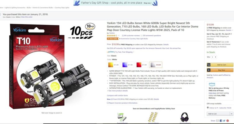

FYI If you replace the bulbs to LED make sure they are CANBUS rated!
And You Tube has videos on how to remove the covers and replace the bulbs !

Updating bulbs to LED is infinitely easier than dealing with most dealership warranty BS.
I would say you're lucky to have the option to be able to change incandescent bulbs to LED.
There are many YouTube videos on this subject and with smart purchases, a very minimal cost.
Amazon has lots of great deals on LED bulbs.
Try using the search utility in the upper-right with console LED upgrade or interior LED bulbs.
I've changed exterior lighting on my truck to LED and very happy with the results.

Watch videos and see how to lower console if U have to. If you have the console where U push the plastic to turn on the light, a lot easier. Otherwise dropping console, besides 2 screws in eyeglass holder, and outer tabs all around, there are also (2) interior tabs in the center. When I did mine, was unaware and I BROKE both of those tabs. So make sure U educate yerself immensely before you pull console. There is also only so much wiring length also to attached points.
