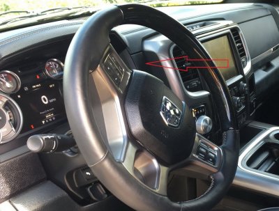

I added a light bar, and a set of orange flashing utility led lights to my truck. I'm trying to come up with a good place to mount the lighted mctuning rocker switches on the dash. I'm down to the only two choices I can find:
1. Below the steering wheel and to the right, above my right knee, there is a blank panel there with some space with nothing behind it I could cut it out and mount the switches.
2. To the right of the gagues, there is a small strip of plastic that looks fairly easy to get out (remove steering wheel cover plastic, then pull that panel which goes around (outside of) the gauges out. Anyone try mounting anything in this location? Anything behind it?

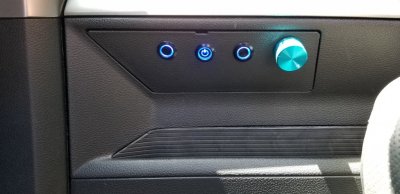

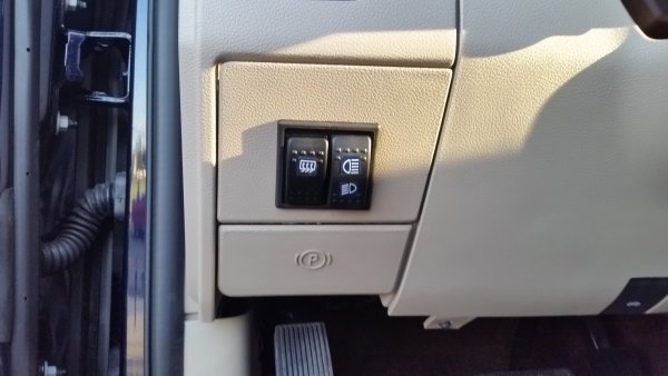

I put mine by your left knee. There is little panel below head light dial that is removable and replaceable if you change your mind...
Pa.hemi.ram
Sep 15, 2017
547
163
Pittsburgh
Hemi 5.7, 6" Rough Co lift, Fuel wheels, Bully Dog Gt, K&N CAI, Magnaflow Exhaust
Exactly where I put mine. Honestly that way if you don’t like it you buy a 30 part and your back to normal

I can't use that panel, I have the 8 speed.... that was the first thing I looked at (before reading around here..), poped that off, and found a pull cord wrapped up in there.... ;)

I used the panel on the left side of the dash just like monteholic's setup.
