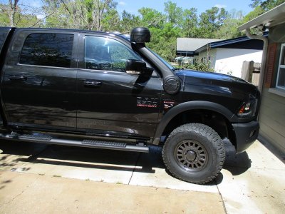

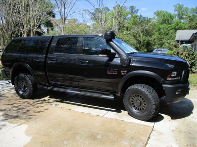

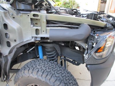

Thanks for the comments. I decided to go for it. It was not as easy as I thought it would be. Drilling 1 inch holes in a good fender is a little nerve wracking! Anyway, it's done and I love it. I have both the ram air intake and pre-filter. I decided to start with the pre-filter. It looked like it would be better at keeping water out. On board air is my next project. I have to let the funds accumulate for a while though.

Looks great! My truck is a 2 weeks old... cutting into it would be super nervewracking!

Nice write up. I was wondering where the air came from on the stock set up.
Will you be lengthening the other breathers or you don't plan on going into deep water.
Not planning on raising it. I think it's good enough. Mainly for dirt and dust. The SY-KLONE prefilter is supposed to be excellent at prefiltering the air. It's used on military vehicles. I noticed a distinct change in my exhaust note. It's more noticeable on acceleration.
