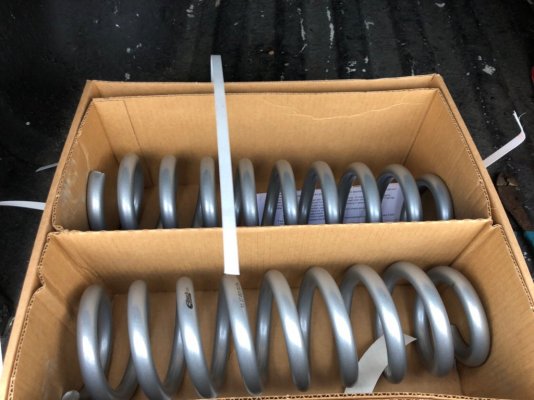

I added the Eibach Pro Lift springs to my 5100’s adjusted to the third notch. Truck rides great, and sits perfectly level. Got them from Nick@GotExhaust, a vendor on the site

So just so I’m clear you added the spring only to the billsteins and you are set at 2.1 plus the 1.5 inches from the coil? How is your geometry? Do you have a heavy bumper?

Copy/Paste from one of my threads:
-In with the new!
Set at 3rd notch, and got me much closer to level:

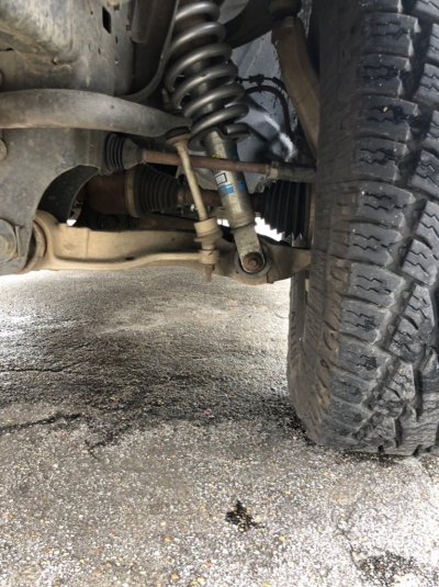

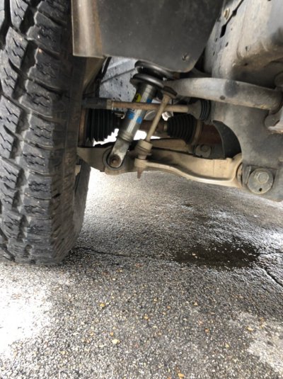

Obligatory CV/control arm angle pics - it’s been raining here, not a leaking truck, lol.
