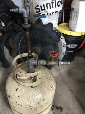

For those diy guys out there who think there has to be a better way, we build a home made sprayer that sprays a 50/50 chainsaw bar oil and WD40 combination using a long wand attached to a modified car paint sprayer. The WD40 creeps the oil into the tight corners in a vehicle and has been protecting our vehicles for years.
Works very well.
Typically takes about a 1/2 jug of each per vehicle.

I will pull out the rig and upload some pics. We typically spray in the fall so that the oil is freshest going into winter.
smoke8r
May 18, 2020
23
22
kingston, ON
2020 1500 sport crew cab blackout package
Here is a couple pics of the setup.
In the picture of the tank, The bottom port by the red tap is connected to the air compressor.
The top port comes out of the tank and is connected via air hose to the paint inlet of the paint gun.
The second tank pic shows the tube go to the bottom of the tank.
The last pic is of the converted car paint sprayer with a long and short wand to reach tight places. The setup works very well. The white adapter leaks a little from years of use but overall it's a sweet set up.
Feedback more than welcome.
