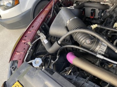

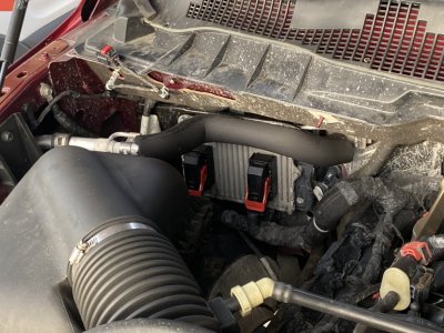

Ok. It’s been pretty hot and humid here in south Florida. My ac has cut off sporadically a few times during this heat. It’s usually only for a few seconds as I’m the only one that notices. I can smell a humid smell through the ac vents when it happens so I know the ac shut off. I’ve done some fiddling with the truck to try and deduce why it’s shut off. I’m pretty sure it’s from heat soak causing high pressure in the lines. I can touch the vacuum line from the firewall to the compressor and with the ac on it’s warm to the touch. The high pressure line is extremely hot and will burn you. Under hood temps are high currently with these high temps. I installed some insulation on the vacuum line from the firewall all the way to the compressor to see if it would help. Well now my vacuum line is cool all the way to the compressor. I’m pretty sure my ac feels about 3-4° colder at the vents even with temps into the mid 90s here. Also my ac has not cut off on me since installing the insulation. It is closed cell fire retardant insulation bought at home depot in the hvac department. It is for ac vacuum lines and water heater hot side lines. It is good for heat and cold and being closed cell will not absorb moisture. In theory the compressor should now run cooler which should increase the compressor efficiency and prolong the life of the compressor as well.

All factory still. It has never been touched. Condenser is clean. I rinse it out every time I wash the truck. I do not have gauges to check with either. The line from the condenser to the evap was burning hot. It’s definitely not burning hot anymore since insulating the vacuum line. My ac runs all year. Coolest weather we generally get is in the 50s during winter if we are lucky and that’s only for a few days.

Since insulating the line it is no longer burning hot. I think the Ambient heat was causing exaggerated pressure in the line as well as high engine bay temps. Heat soaking the vacuum line was drawing excessive heat into the compressor more so than the condenser could remove. Theoretically all that heat into the compressor was making it work harder which would increase heat and reduce efficiency. Like stated since I’ve added the insulation to the vacuum line everything has been fully operational and no more issues and the liquid line is no longer burning hot.
