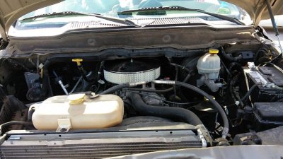

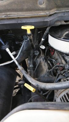

Hey guys at the end of getting parts for the install. Looks like I'll be making the s bolt can't find one. Two questions. On the push in breather filter. What size do I need? On the s bolt what size of threads do I need? And factory bolt I can order one for? BTW can find a aluminum spacer so may have to run plastic. But it will be a temp thing anyways as I plan on going sc down the road.
JustinH
JustinH
Aug 15, 2017
34
2002
Magnum 360
My local AutoZone can't order that anymore. I'll check o'reillys and see if I can find advance. What about the push filter does it need an adaptor? Or what diameter do I get? As always thanks for the help. Looking forward to getting it on.
JustinH
JustinH
Aug 15, 2017
34
2002
Magnum 360
So I did a Jimmy rig lol made the S bolt and only ran a half inch spacer. Removed the plate on top of my TB to gain some extra clearance. And just grabbed a push in Spectra filter and just pushed onto the elbow. Might get a catch can later though more for looks. Only ran the spacer cause of clearance issues with cable brackets. Anyways here are some pics if completed install. Next is exhaust. received_2367290210221206.jpeg received_787174374999145.jpeg received_378233613037340.jpeg
