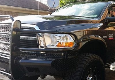

Hello Everyone,
I have a 2011 2500 5.7L Hemi. I have read alot about this topic on the forums and I really like what I have read about the Vararam air grabber an the S&B intakes.
One question is do I need to have a Ram Air hood in order to utilize the Vararam intake system?
Also I like to go offroading and mudding so would the S&B be more practical for this because it is enclosed?
Thanks in advance.

The Vararam will work with both the RT hood and the regular hood because it actually pulls all its air from the grille, not the scoops in the RT hood.
As for using it offroad, both will work fine as long as you arent driving through high water. Only time I have seen an issue with the Vararam offroad was from guys that are running though 3' of muddy water. That can get around the seal of the Vararam. If you are driving through that stuff with the S&B, make sure to put the plug on the 2nd air scoop to prevent that sludge from being sucked in through the bottom of the airbox.
