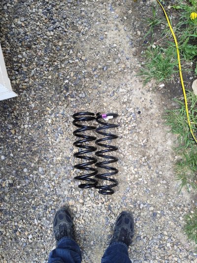

Coming from two former 3500 trucks I do like the soft ride. I ended up going the route of Tuftruck 1211 springs instead. While the ride isn’t as soft, it’s nowhere oven close to as jarring or rigid as 1 ton rear suspension.
