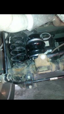

millwrightguy
Apr 5, 2015
12
6
5.7l hemi
I think air bag inside of coil is silly. I way rather prefer my setup
