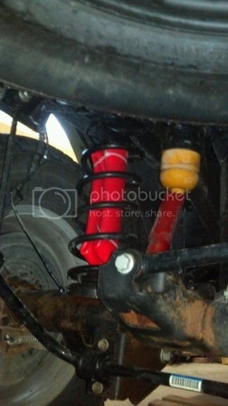

Just ordered my airlift 1000's. Hope they are as easy to install as they make it sound.
very easy man, just make sure you drop the rear end to open the springs up
i wrapped the end of a pry bar with tape and used that to help put the bags in.
the hardest part was getting the airlines on the barbed ends other then that
1-1.5hr and a few beers later, no more sagging. good luck.
They really are that easy to put in. I used a12" piece of 1" dowel with the end rounded to help feed the bags through the coils.

Make sure you take all the load off the suspension. Get the tires in the air if you have to. Cake after that.

I put my bags on top of a heat register and cranked the heat for a while. They folded enough that it was super easy.
Nice tip. Wish I had thought of that...
Did yours come with two of the black spacer things per bag, and did you use both?

Mine only came with one black circle for each side.

^ that's a great idea.
I didn't have a jack capable of fully getting the springs unloaded, and despite my 80,000BTU heater nearby is was cold as f*ck in my garage; there is no way I would have thought of that. The floor register idea came to me on one of my many trips inside haha
