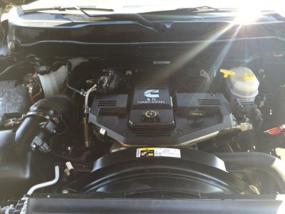

The FORD dealer may not know what they have on their lot??? They list this truck as having the 66RFe but I am almost certain from the pictures they sent via text of the actual truck that it is the Aisan. Could someone take a look at the pic under the hood and confirm this for me so that I don't jump in and make a big mistake. I really want the Aisan for towing a heavy 5th wheel through the mountains in retirement.
My understanding is that the Aisan dipstick is on the drivers side but i do NOT know if the 66RFe is also. I think the 68 is on the passanger side from what I'm reading on this forum.

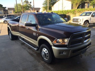

Good looking truck btw....Love that color...

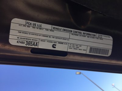

Looks like the Aisin. Can you get the Vin #?

Id be looking for the original window sticker. Otherwise, decoding the vin will tell u all u need to know.

Run the VIN at the Ram site and you can get the actual build info.
F
finnrigged
May 7, 2017
Cummins 6.7
Difficult to interpret their "codes" on the VIN decoder Tech Specs tab but it has the following in the transmission catagory:
Trans Order Code DF2, DG7, DFP
It looks like it gives 3 different trany codes...but maybe the first one in line is the one that is on the build????? That being the DF2...I believe to be the AISIAN. Is that how you read these code lines in the RAM vin check? First code is on your's...other codes are options...

The Aisin transmission has the dipstick on the driver's side, the 68RFE is on the passenger side.
The exhaust brake is standard issue on all fourth gen Cummins and is control by a switch in the center stack.
