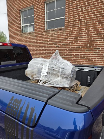

I am getting ready to start my G56 swap on my 17 power wagon. Truck has about 92k on it and I smoked the overdrive clutch in the 66. Totally my fault, I'm an idiot. I have wanted to do this since I bought the truck 3 years ago so the trans losing 4th, 5th and 6th really just gave me the perfect excuse. I have found a 2006 hemi g56 and ordered just about everything I can think of. I'm sure there will be a hurdle or two. I have tuning lined up from AJ at hemifast and should get that at the end of the month. I can't start tearing into it until that is in the mail since I am doing this at a buddy's shop. I have been keeping track of all pricing for this and so far I'm around 3500 all in. Now with the tuning that will go up some. I have been doing other things along side this though. Spark plugs, brakes, fixing an axle seal leak. So I'm trying to keep prices separate. I have ordered as much OE stuff as possible. All my shifter boots and the shifter itself is factory stuff. Clutch pedal and all the stuff to mount it is all factory. My goal is to be under 7k which is the cost(ish) if a built 66rfe. I think I'm on my way to making that happen. I will keep updating as I go. Hopefully taking pictures along the way.
