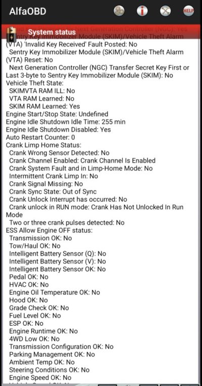

Ok i am stuck been stuck on this issue for a while I have a very heavily modified 2016 ram rebel with a 6.4 426 stocker long story short is after the swap i cant get the air lift suspension to work i go in the alfaobd to fix the suspension but when i start any thing on the suspension setting is says limp home Status active and i cant for the love of me figure this out there is only 4 engine lights and they are to deal with the o2s which i cant see is related because the same goes was on the old 5.7 when i was racing then. So I don’t know if it is something i did or not but I need help because the truck is on the ground and it wont raise up. Any advices helps thanks
Also under engine limp home is no

My stepson stepped on top of the front airbag and broke the 90° adapter. I bought a new one and installed it. Add nitrogen back to the system and went through the whole process deal but I missed a valuable step. When I did the programming I did a programming on off-road one when I should have done it on off road too because I have a rebel edition. So the symptom that I was seeing was it would never go into off-road mode and normal height was off-road for me when a week or two later I went back into the settings to refix this setting. This is when it went into limp mode. I had it working but not anymore. I have to talking to one of the guys. I'm wondering did I leak nitrogen back out but if I had it would have told me low air mass because someone else said that in order to get out of that mode they removed all the air, pulled the vacuum and recharge back with nitrogen and that took him out of lint mode. I do not see how the hell that takes you out of limp mode but I've seen weird as **** in my time.

Update
Ok I was able to get the truck to raise up
If I was in ACC and not Run it would let me temporarily bypass limp by letting me fill springs from the reservoir so I could get it off ground but on ACC and some of the settings limp home would still pop up. I think this is from the abs a few of the wheel sensor are not reading causing the abs/ traction control light and break light to all be on. I think this is the cause of the limp home I am going to spend the next week or so trying to see if I can fix this. Issue. Then I should be back on the road full time again.
