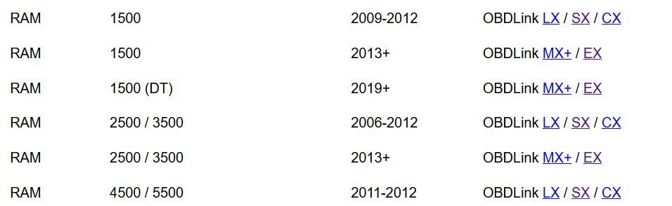

I think I'm hooked up, etc but can't seem to get to where I need to go.
I have gone into the body computer area but it has listings for all kinds of crap and vehicles.. I'm wondering if the license key applied. When I launch the program is asks for the make, model but not year which I find puzzling.
one issue may be the interface cable. I bought the SX cable as suggested. But I note their application guide call for the EX cable? Screen display also mentions EX cable or MX.
I'm going to head back out and :banghead::banghead::banghead: but will try to monitor this from my cell. I hope
