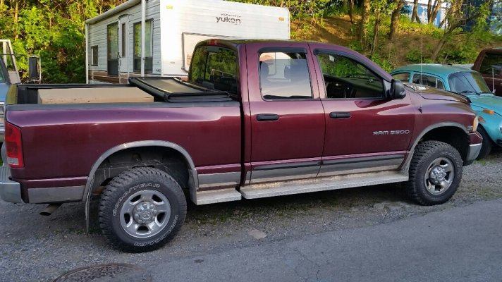

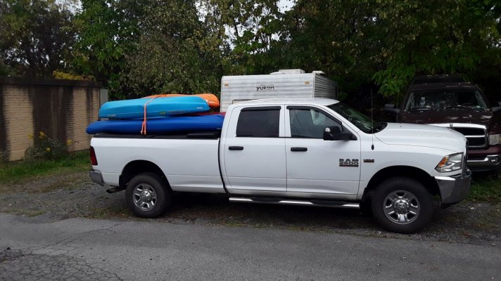

Well...never mind...i guess they both sit back from the cab...i thought the 3rd gen sat up closer too it and curved...but guess that is the 4th Gen.
Your idea might just work 2018-03-02 09.52.18.jpg20170704_113857.jpg20190929_160643.jpg
392DevilDog
Aug 25, 2019
1,954
2,957
Glasgow, Pennsylvania
392 Hemi
If you look at the back of the cab and front of the bed. The 2nd gen (red truck) is straight up and down. Now look at the 4th gen(white truck) see how the back of the cab/front of the bed is curved.
I thought my 3rd gen had the curve too. But it is straight like the 2nd gen.
So a 3rd gen to a 2nd gen might just work. Depending on the width of the frames. You could probably make the mounts work.
