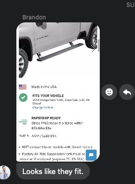

I saw some Amp Power Steps for sale on FB Marketplace new in the box for a really good price and grabbed them, I wasn't near a computer to research fitment heavily but I told the seller 2016 Ram 1500, he checked a web site (don't know which one) and it said they fit.. cool...

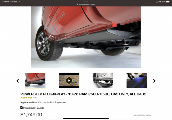

The photo is from their website. Cab isn’t the issue I don’t believe. Since this set you have is Plug ‘n’ Play, this might be an issue. The security gateway didn’t start till 2018, and since you have a 2016, there’s no security.
Hardwiring would be one solution. It’s a pain to do it because of where the connections are made. Plug ‘n’ Play is the easy way. Call Amp and see what they say.
