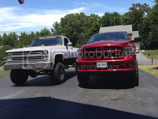

Finally pulled the trigger and ordered my RCX 6 " lift last Tuesday ( July 1). This lift came Thursday and I spent 5 hours Thurs. night taking the truck apart and 5 Hours Friday morning finishing the lift. Overall I am pleased with the lift and so far have no issues or complaints. I went with 35x12.50 Kumho Road Venture M/T's on factory wheels with a 1/4" spacer.. The white truck is my 1987 Chevy 1/2 ton with a 6" suspension and 2" body lift on 35's.
Not bad for a New Truck with 5,800 miles.

Looks awesome.
Good job!

Pretty satisfying doing it yourself. I think it looks great! Although I wouldn't be able to help myself and would end up with 37's.

Looks good. I've got about 1000 miles on those same tires and really like them

Nice! Did you put the 1/4 spacers on all 4 wheels?
Yeah I put them on the front and back. I have enough space up front between the knuckle and tires to fit two fingers side by side. Without spacers there's no way I could fit 12.50 Tires.
