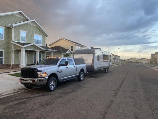

This is our set up. Tongue Weight is right at 1500#s. Used my weigh safe hitch to figure that number.

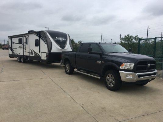

Not that it will put you over payload but that tongue weight is pretty light. My son has a 2018 Grand Design Imagine 2670MK and his tongue weight was around 1100lbs. His is about 32' from tip to tip. He has a 2018 2500 6.4 with 4.10's and it towed it easily. We just towed it 1400 miles to Texas about 5 weeks ago and last year he towed it 1500 miles to North Dakota and back.
You should probably be ok with either of those but definitely a good idea to get actual weights

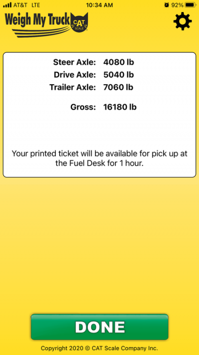

Here is my sons setup with a weigh slip.

Something to keep in mind that I would probably not realize if I was just reading this but this weigh slip shows the trailer being 7060lb. That is not including the 1100lb tongue weight that is being transferred to the truck. So the total weight of the trailer alone would be about 8100lbs. Dry weight on the Grand Design site says about 6600 IIRC
