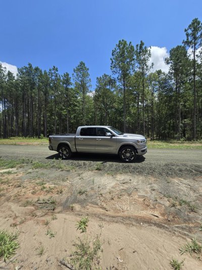

Hello all hope everyone is doing well. I have a 2020 Ram Limited with Air Ride System. Im going to get a travel Trailer and want to get some feed back on issues I may have towing it. First off I been seeing different max towing weight from 7500-12500 max weight. I will be traveling from Houston ,Tx to near Pineland,Tx Northeast Texas. I seen a travel trailer i like and it weighs 9000 lbs my question is .Would that be ok to tow and go to other locations around Texas? With it being an Air Ride System. Will i have problems with Air ride System. Would really appreciate any and all feedback and what to expect while traveling and towing this trailer. I thank you all hope to hear from you guys soon...
