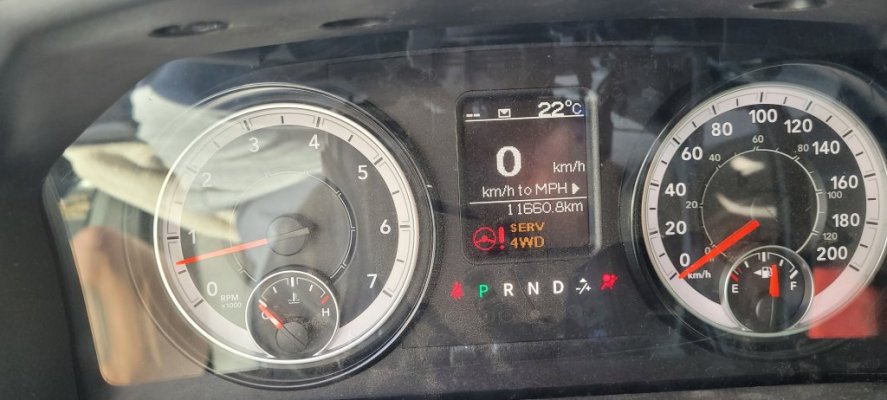

Any way to turn off service electric power steering light. (Now have regular power steering.
ross-demers
Jun 13, 2023
6
prince rupert bc canada
2006/2018
Any way to turn off service electric power steering. (Now have regular power steering. To explain I put engine,trans,dash from a 2018 1500 into my 2006 2500.
I tried alfa obd app but does not let me change to not equipped, the option is there but start will not highlight.
I hread there is better alfa app for pc anyone now if it will let me make this change? I know I can have pcm sent yo dodge but is my daily driver now.

Il be watching this as il need to do this when my rack craps out one day and i go back to regular power steering from a older 4th gen hpefully someone will figure out a way.
