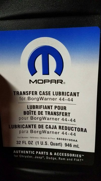

Uh-oh... I went to the local chrysler dealer and they sold me the borg warner expensive as fluid (The blue **** i think) I wonder if thats why my truck makes a grinding sound while in engagine reverse and shifts into 4th. I have been driving it with for roughly 30k miles
Sounds like the 44-45 is much better than the 44-44, why would someone pay more for it lol

First off, do you have the 44-45?
Is this the fluid they gave you for the low low price of $42/quart?

I must, i only have 2wd 4 lock and 4 low, and yup
Well the good news is you have the better tcase. Congrats!
The bad news is the dealer sold you, or rather, ***** you for the wrong fluid. I would get that out and put in some ATF+4 like Castrol Transmax ATF+4. Had good luck with this fluid.
Probably not hurting anything but still its not the right fluid and that would bug me...
