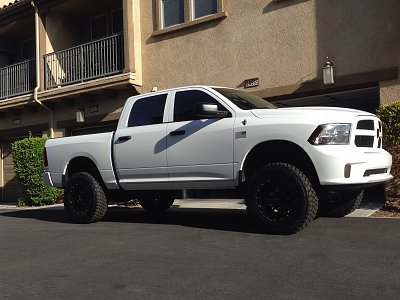

i have the factory 4" from the factory, got a freaking smoking deal on the truck so i got it. ill post a pic tonight when i get home

here is a pic of when i got the truck, looks a little different now

Steveo8x8 looks rlly good.is there anything else in that setup or just the factory lift an wat tire size is this? an thanks for the photo and info
no i havent touched anything else in the suspension besides airlift 1000 bags. the tires are 35x12.5x18s
