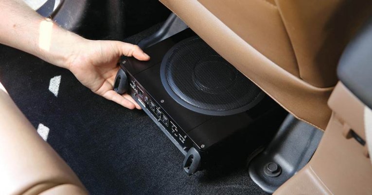

Would have to be one hell of a pancake sub to fit back there in proper enclosure. You’d be better off getting an under front seat woofer.

There are a lot of compact under seat powered subwoofer options, you're going to pay more for a quality brand that still may not perform as well as a traditional pancake or slim in a larger enclosure.
If you're adamant about keeping the rear under seat, you could always do a nice active or passive setup with higher power multi-channel amp using the factory door locations upgrade for more low end.

Don't waste your time with the small under the front seat subs. Full size 12" subs fit perfectly under the front seat and will give you a lot more power and deeper sounds

Ok I know we all have different taste in music. I like to hear everything, highs, mids, and lows.
I have e a single cab and didn’t want a sub taking all the room behind my seat, which there isn’t much of anyway.
I got a 6” JL Audio sub, along with Boston components in the front doors, and Morel components behind. Upgraded the 3 speakers in the dash as well.
Here’s the sub:
https://www.crutchfield.com/S-UuT7E...zcfkae1N815vxcJok-zxoDc1iReiM-NIaAnkAEALw_wcB
I have an Alpine MRD F754 “old school” amp.
Point is, the bass is tight and as much as I could want.
The sound is amazing, of course that’s my opinion. I realize that if you want to rattle your windows then the JL Audio sub isn’t for you, but you do get a lot of bass in a small space.
