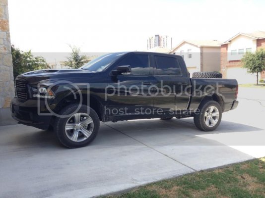

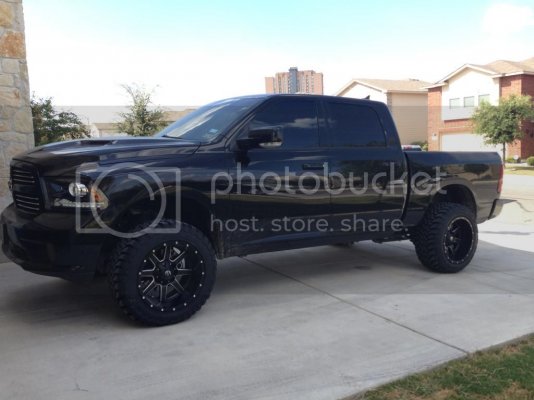

Absolutely no rub. About an inch clearance front and back. Really wish I would have tried them without the 1.5" body lift.

Oh that's sexy as hell! 33x12.50 right? What lift size, just the body lift?

That looks good. Too much trouble for me to clean but looks good. I only have a reg cab now and pay the guys at my dealership to wash it most of the time.

That looks great actually, can we get some different angles to see how it stands? Like front angle shot, rear angle shot and straight down the sides??? Running spacers isnt really what I wanted to do so considering my wheel options after BL

Yeah. I just threw them on last night in about 30 minutes. Wanted to get a before and after shot so that's all I snapped. Lol
I'll take a bunch of pictures soon.
This would have fit without the body lift providing you had 2.5" of level. QuietPeen has the same tire size (Toyo MT) on his with a 2.5" level
Either way, it looks good man
But he's on 20x10's, not 12's. :favorites13:
