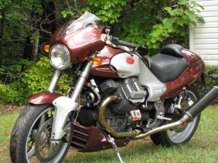

You may be right, I don't think our somewhat stock engines are capable of running out a 3:55 gear in a truck. And oh yeah, I have played with bikes for years and know what you are talking about. My project bike is a 97 V10 Moto Guzzi using a Daytona engine, 6 speed, extended swing arm and 6" rear wheel.
