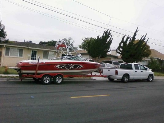

I have 29.5" tires (275/60-17's physcally measured from ground to top of tire), started with 3.92's..then upgraded to 4.56's, loved them...then bowing to peer pressure, I changed them to 4.10's..they were ok but when a friend gave me his 4.56 gears after selling his truck, I threw them in and am loving it... only problem i now have is traction related at the track... with dr's or slicks..

Fred, that is a very nice boat! You have good toys..
