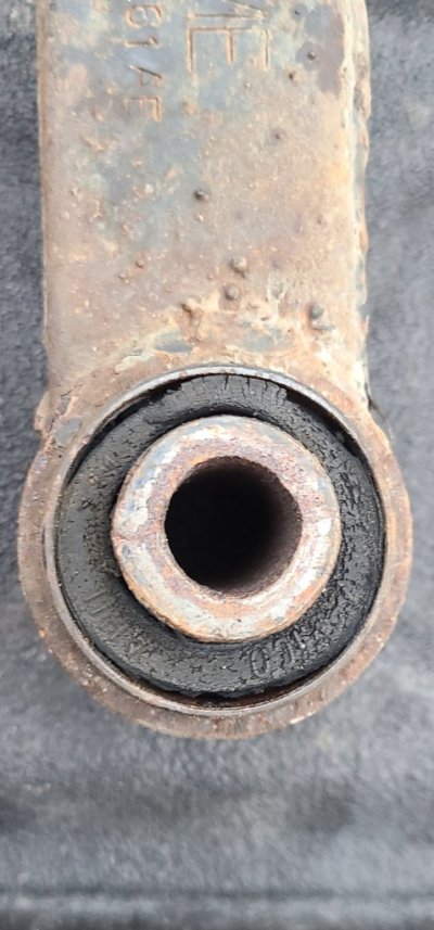

Just a suggestion, have the lower control arm bushings checked.
I have a '17 1500, 4x4, Hemi, 285k.
At about 225k I experienced a row boat feeling at highway speeds, feels like you can't control the truck.
Bushings were shot (see pic), replaced the lower control arms and problem solved.
Keep up with Fluid changes and maintenance and the truck will last.
