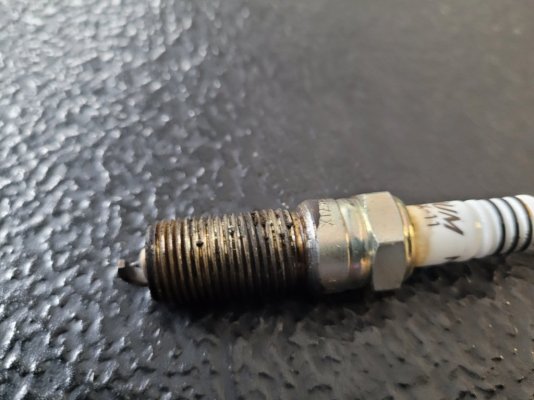

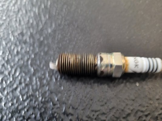

Results of compression test below. No real findings other than oil present in number 7 spark plug hole and plugs were hand tight. No ratchet used to take them out.
The others were almost identical. Gap upon extraction was.33 , tuner recommended gap was .32. Plugs were in for 30 k miles

Well, cold start this am, no smoke. My conclusion based on everything I encountered. Oil in spark plug tubes on cylinder 7, occurs because of leaking valve cover gasket. Plug change had two impacts. First oil in spark plug tubes drained in cylinder upon spark plug removal. 2nd installation of new plugs resulting in them being tighten to 13 ft lbs. No oil present doesn't have ability to leak into cylinder to cause smoke on startup. Plugs being tight leaves no pathway for leaking into cylinder.
Solution is replacement of valve cover gaskets. Damn, I hate taking all that $hip back apart to replace covers gaskets.

Replaced the drivers side valve cover gasket yesterday, what a PIA. I can now see why the book says its a $500 plus repair. I think I had almost every component on that side loose or unbolted.
So previous to replacement at about 500 miles both spark plug tube were full of oil, when taking the cover off, the gasket for those tubes fell out when cover was removed.
Anyway, it's fixed and tomorrow's 500 mile drive will reveal if I did a good job or if I get to do it again. Based on no oil leaks and no smoking, I think it will not be a problem.
