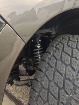

Here’s my 6” BDS with Bilsteins max and Zone arms.

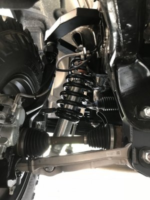

Here’s the Zone arm on just a lift kit without Bilsteins, he didn’t need it so it pushed his geometry out of whack the other way.
