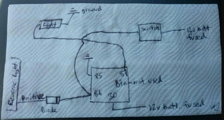

I've read numerous threads on installation and it seems many people have no issues while others run into problems with essentially the same method of installation on the same trucks. Many use the 7-pin trailer harness while others use the tail light housing for the trigger wire. Some have had issues with inexpensive lights b since I'm using Baja Design lights, I feel like I have a high-quality lighting product. I may try putting a diode between the relay and the lights to see if it's a backfeed issue and maybe double-checking my grounds. Something like this (note: I'm not using a switch).

^ That's circuit is an acceptable way to wire it and if you do not have it I would install the diode just for good measure. I'm running several lights off my reverse and high beam circuits with no issue but have diodes on all of them.
With that said, I really don't see how that is affecting your parking alarm. You could disconnect the lights temporally just to verify but I'm leaning more towards a faulty backup sensor?
