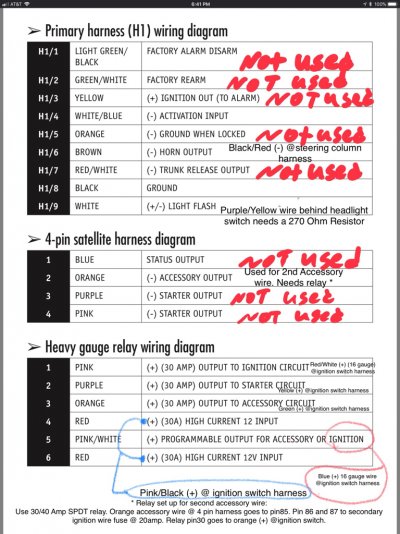

Here is some notes from when I installed the Avital system in my
2003 Ram Quad Cab 4X4 4.7L
Bulldog Security has great info on locations of the wires. some of their info is not correct though.
I did not have to worry about factory security my truck does not have it. My notes do not cover installing on a factory security system.
When I find time I will try to do a full write up on the install.
Hopefully my notes can be helpful to someone.

any elegant solution getting the hood switch wire to the remote unit such as an unused wire in harness? I've got a module for the immobilizer (uses a programmed key) and a wire threaded up to the ignition switch. I think I've got all the correct resistors (I'll do a check probably today). Clearing out garage from some home improvement projects this summer and anxious to get started.
