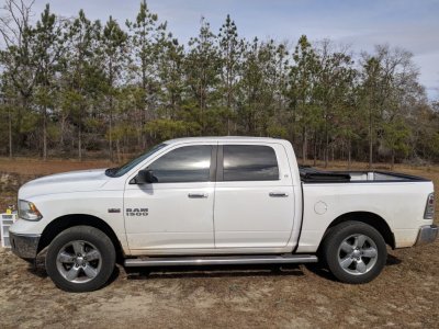

Got the front bills on last night - 2.8 and feels great! Also got sway links and new UCA's installed...worked on her for over 10 hours!!! Worth it though. Here's before and after pics.
IMG_20171216_110836.jpg IMG_20171217_121225.jpg IMG_20171216_110847.jpg IMG_20171217_121153.jpg
CunningStunt
CunningStunt
May 12, 2017
340
320
Abbeville, AL
5.7L Hemi 4X4 Crew White/Chrome
So it was a day job :) congrats
Touche good sir
I found a 20 dollar set of pass through ratchet and it was the tool of the night brother. Especially that upper strut nut/hex head shenanigan...
Also found that removing the upper ball joint just requires 5 mins of patient tapping all around with a bit of silicone wd40. The first one about made me throw my Bils across my yard ha
I don't know if I'm gonna be able to wait till I HAVE to get new tires...I already want more another inch or two!
