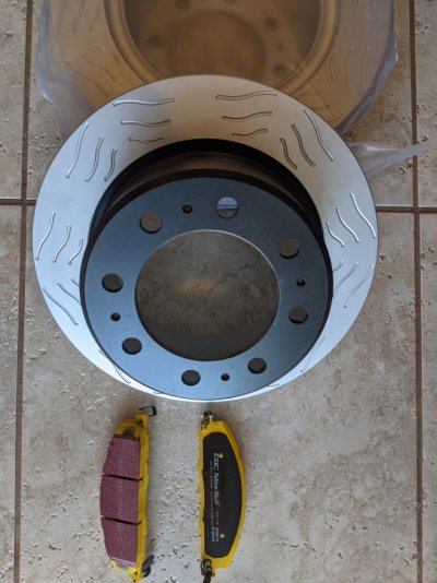

You know... funny you should say that! I totally forgot the only other change from OEM components made to the truck was the installation of Slotted Brake Discs and the addition of EBC "Yellowstuff" Brake Pads at all Four corners some time back.
Very, very interesting suggestion. I guess the quickest way to try and check that theory would be to drive it to a High Pressure Wash Station and thoroughly spray down the rear brakes, then immediately go and back it out of the stall and around the lot and see if there is any notable change.
There is a wash 65 miles from me (yes, I do live in the sticks). It is the perfect distance to have everything all warmed up from the drive over, and be able to do an immediate "before and after" comparison. I shall do that today! If you are correct 4Xdad, I will owe you big time! ;)
Just for kicks, these are the parts that were swapped on. It would make total sense for a higher performance set of rotors and more aggressive pads to slightly stick and 'chatter'. Especially when 'warmed up'. Though I have never before in my life experienced such a thing, after many different vehicles, brake swaps and track days of all sorts and no drag can be felt from the driver seat or is revealing itself with any inability to seemingly roll freely on a slight grade or in reduced MPG. But, who knows, with such a heavy truck, I suppose it is possible.
