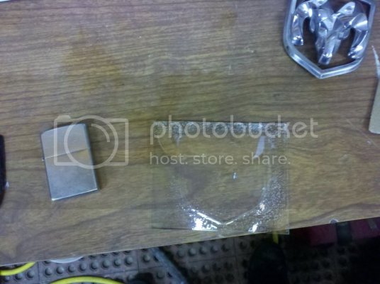

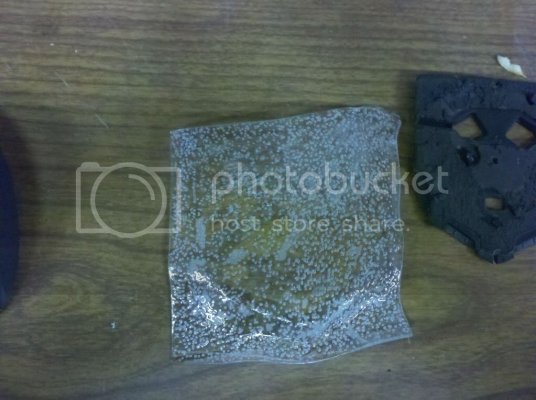

so i borrowed my uncles toaster oven and well....... trial and error right. they make it look so damn easy on you tube.
OklaHemi
Jun 25, 2010
4,254
25
04
new age hemi
ha ha. looks like you had it a little to warm. why did you stick the black piece in there? you should have left it out, Warmed the plexi up took it out and pressed it againdt the black piece to mold it.
bigtigga84
bigtigga84
Dec 19, 2010
3,459
35
dela....where?
2006

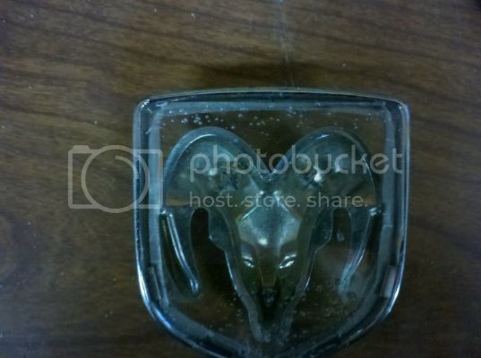

that's how i did it the first time and it pulled when went to take it out. putting the black piece in the second time and it worked a lot better actually. yeah the bubbles suck, might look kinda cool lit tho. if i can get it to fit in the silver part the way the black back does, im gonna either sand it or vht it or both. the vht so it will look dark until i hit it with light
bigtigga84
bigtigga84
Dec 19, 2010
3,459
35
dela....where?
2006
trust me so am i. argued with my dad for an hour this morning about how to do it. he was insistent on baking the plexi. so that way will be tried first.
bigtigga84
bigtigga84
Dec 19, 2010
3,459
35
dela....where?
2006
second one i did with the black piece in the toaster too. used a plastic know to push down on the plexi around the black piece so the edges were more defined. gonna take it with me to my dads tomorrow to cut it out. i can't find the tips for my dremmel and the one i have just doesn't work at all. hard to get nice edges.

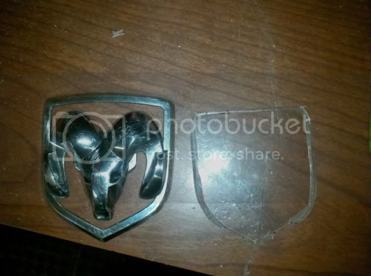

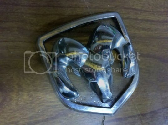

ok so i got the new piece cut out tonight. didn't do to bad of a job, but it's gonna be hidden so i wasn't to concerned about it.
had to cut out these pieces to make fitting the plexi in easier
