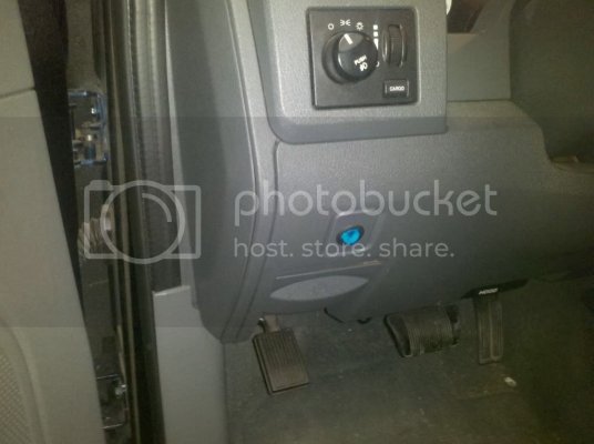

Well, last little bit done tonight. Wired it all up and installed the switch. Blank plate popped right out. If you use the same style switches, have a 3/4 drill bit. Its a pain in the ass with a dremel lol

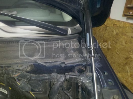

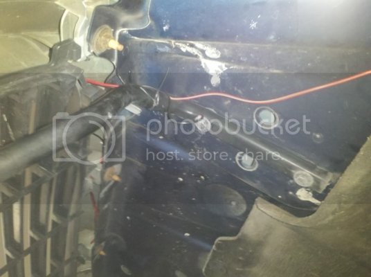

Grounded too the hood, power wire ran behind noise barrier or whatever it is
Down the strut and zip tied

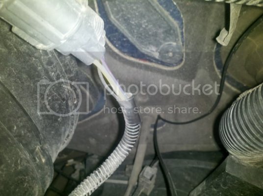

Through the firewall were the parking brake cable comes through
